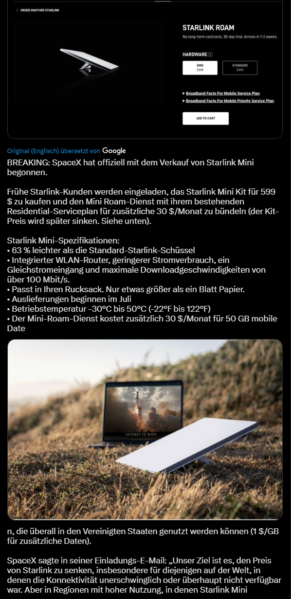

    image.png?ex=6678255a&is=6676d3da&hm=844b90acaffee85f70d0b12c5434ba2233b750eb0fa863e1a779468da4d006bb&=
